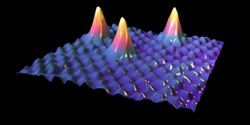

Figure 1. A scanning tunneling microscope reveals three platinum atoms on the surface of a model copper single atom alloy catalyst. Source: Charles Sykes, Tufts University.
Results showed the platinum breaks the C-H bonds, while the copper helps couple hydrocarbon molecules of different sizes, allowing conversion to fuels. The researchers also report that the single atom alloy was very stable and only required a small amount of platinum to work.
“Our scanning tunneling microscope allowed us to visualize how single platinum atoms were arranged in copper. Given that platinum is over $1,000 an ounce, versus copper at 15 cents, a significant cost saving can be made,” notes Sykes.
