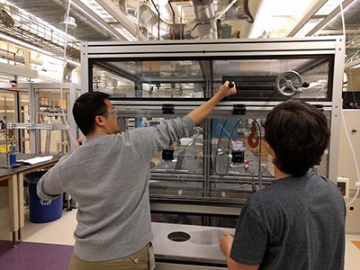

Batch Reactor
Figure 1. Pressure vessel is immersed in a 450°C sand bath for several minutes. Source: MIT Energy Initiative, © Stuart Darsch.

Contact with supercritical water also enables economic upgrading of crude oil itself with greater selectivity to lower molecular sizes. The Green Research Group at the Massachusetts Institute of Technology (MIT), Cambridge, Mass., has a broad energy program involving breakdown of heavy Saudi Arabian crude. The group relatively recently published a paper on its experimental approach, “Supercritical Water Treatment of Crude Oil and Hexylbenzene: An Experimental and Mechanistic Study on Alkylbenzene Decomposition,” Energy & Fuels (2015), that demonstrates the difficulties that all chemical processors initially must face in studying a new supercritical water opportunity. The MIT group used a small sealed pressure vessel that was lowered into a heated sand bath at 450°C and held there for some minutes before withdrawal (Figure 1).
This immersion technique is a relatively simple way of establishing a rough value of the benefits that supercritical water processing of a material offers. However, practical feasibility inevitably will require continuous operation. The needed equipment probably should be based upon a commercial extruder to contain the high pressure of supercritical water and simultaneously to manage, with computer controls, the very brief reaction periods employed. U.S. Patents 9,932,285 and 9.932,532, issued on April 3,, 2018, describe such continuous supercritical-water chemical processing equipment.
