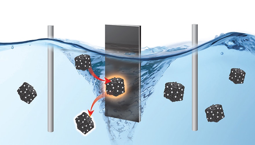

Fluidized Electrocatalysis
Figure 1. Catalytic particles work in rotation and become momentarily “electrified” when they collide with the electrode, leading to improved fatigue resistance. Source: CCS Chemistry/Northwestern University.
“Fluidized electrocatalysis breaks the spatial and temporal continuum of electrochemical reactions, making the catalysts more efficient,” says Jiaxing Huang, professor of materials science and engineering at the university’s McCormick School of Engineering, who led the research. “Fluidization also reduces the mass transport limit of the reactants to the catalyst, since the particles are swimming in the electrolyte.”
