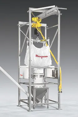

The Bulk-Out Bulk Bag Discharging System from Flexicon is designed for use in explosive environments. The BFC series model features a pneumatically-powered hoist and trolley to raise and position the bag inside the discharger frame, reportedly eliminating the risk of potential sparks from electrical equipment or fork trucks that might be otherwise used for this function.
A Spout-Lock clamp ring forms a high-integrity, dust-tight seal between the clean side of the bag spout and the clean side of the equipment, while a Tele-Tube telescoping tube maintains constant downward tension on the bag as it empties and elongates, promoting complete discharge of free- and non-free-flowing material from the bag.
The all-stainless-steel construction is designed to withstand corrosive environments and allows rapid, thorough wash down with caustic cleaning solutions. The unit is available with a hopper and pneumatically-driven flexible screw conveyor, a tubular cable conveyor or a rotary airlock valve to feed material into a pneumatic conveyor line.
