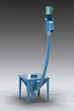

Flexicon introduces a wear-resistant flexible screw conveyor with carbon steel conveyor tube, heavy-duty flexible screw and heavy-gauge floor hopper and discharge housing, capable of moving crushed glass, garnet, aluminum oxide, silica sand, aggregate, cement and other abrasive materials. The screw is available in lengths up to 40 feet (12 m) in round, square, flat or beveled profiles to optimize conveying efficiency for each application. The 4-1/2 inch (115 mm) diameter conveyor tube is available curved to vertical, to horizontal or any angle.
The screw is the only moving part contacting material. Its lower end has no bearing, while its upper end is driven beyond the material discharge point, preventing material contact with the upper seal or bearing. This configuration facilitates simple maintenance in harsh environments since the single moving component can be quickly replaced if necessary.
As it rotates, the screw self-centers, providing ample space between itself and the tube wall to minimize or eliminate grinding. The gentle rolling action imparted by the screw prevents the separation of blends, while the enclosed conveyor tube prevents product and plant contamination.
Supplied as standard with a durable industrial coating, the unit is available with an optional UL-listed start-stop control panel and a range of flow-promotion devices.
