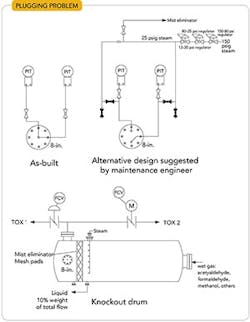

Figure 1. Impulse tubing for pressure transmitters on new knockout drum plugs frequently.
July’s Puzzler
We installed a new knockout drum with a better mist eliminator (Figure 1) to replace a drum that was giving us problems. The new drum, like its predecessor, is at the inlet of two thermal oxidizer (TOX) systems. “Flow is controlled by a pressure transmitter downstream of the mist eliminator,” notes the production foreman. Operations had project engineering install two redundant transmitters in the old drum. However, the impulse tubing for both transmitters plugged so often that the TOX systems downstream tripped on low pressure every few weeks. Those systems run at 2 psig at the inlet with the trips set at 0.5 psig. The pressure drop across the mist eliminator is about 0.3 psig when clean and about 0.5 psig when dirty, according to the manufacturer; our maintenance engineer says 0.75 psi is more like it. We installed two redundant transmitters on the new drum and their impulse lines also suffer from plugging: six months after the new drum was installed, the TOX systems have started tripping again.
Our grizzled, old maintenance engineer is disgusted. He hoped this problem would be solved by now. He says we should have included a steam purge in a manifold and the mist eliminator; he drew up a sketch in a few minutes when I asked his opinion on how to address the problem (see the figure). The young engineer who ran the project didn’t see a need for it, figuring the improved mist eliminator would do the trick.
What do you suggest to solve the problem? Why do you think the mist eliminator failed to work effectively to prevent fouling of the impulse tubing? Is there a better way to control the TOX systems or reduce trips? Is it possible to improve the performance of the mist eliminator?
