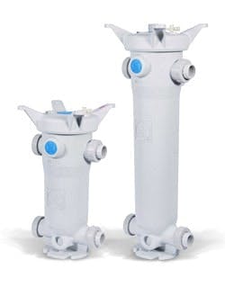

The FLV series all-thermoplastic bag filters feature a one-piece injection-molded platinum GF-PP (glass-filled polypropylene) body in sizes 1 (16 in) and 2 (32 in.). Unlike metal and plastic filters, the FLV offers a true-union design for multiple end connections and sizes, as well as quick installation or removal, says the company.
Socket, threaded, and flanged connections are available from 1 ¼ in. through 4 in. The FLV can be ordered as a simplex through quadplex unit. The filter vessel features a pressure rating of 150 psi/10 bar Non-Shock at 70°F, and a service temperature of up to 240°F/116°C.
