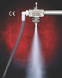

Siphon fed atomizing spray nozzle atomizes a variety of fluids in a round spray pattern where no liquid pressure is available and heavy application of liquid is needed.
Exair’s new 1/2 NPT siphon fed atomizing spray nozzle atomizes a variety of fluids in a round spray pattern where no liquid pressure is available and heavy application of liquid is needed. The corrosion resistant type 303SS nozzle draws liquid into the airstream and mixes it internally while providing up to 24 inches of suction height, according to the company. Liquid can be adjusted using the adjustment valve. The 1/2 NPT spray nozzle provides high liquid flow up to 68 GPH in a 6-inch diameter round pattern. A no drip version to conserve liquids is also available.
