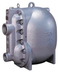

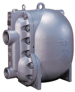

TLV introduces the new GP14 PowerTrap, an advanced condensate recovery system for pumping high-temperature condensate for vented receivers, sumps and other pump applications. The GP14 reportedly provides high-pressure, high-temperature condensate pumping services up to 392° F and 200 psig.  Based on the durable GP10 PowerTrap, the GP14 offers:
• Extended reliability with non-electric design, ensuring no cavitation or seal leakage
• Durable Inconel compression spring
• Energy-efficient, contoured body design
• Serviceability by an externally removable motive valve, which is also protected by an internal secondary screen
• Compact design operates with low filling head and facilitates installation
The GP14 PowerTrap is available in cast iron or cast steel, with connection sizes of 3x2 NPT, 2X2 and 3x2 flanged.
