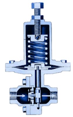

As stated earlier, droop is an inherent characteristic in any self-operated or pilot-operated regulator. However, it can be minimized. The extent of droop is determined by three factors: diaphragm area, spring rate and stroke length.
An increase in the diaphragm area, a decrease in the spring rate and/or a decrease in the length of the valve stroke can reduce the droop. It is important to remember that these factors are interrelated.
Diaphragm area. The diaphragm area is restricted by economic and practical reasons. Larger diaphragms tend to increase the overall cost of the regulator because they require larger spring housings, heavier bolting, etc.
Shown here is a typical regulator valve.
Spring rate. Design engineers typically will use the lowest-rate spring that will allow an adequate range of pressure adjustments (set points) and still retain sensitivity to small changes in pressure. It is possible to reduce the droop with low-rate springs, but plants run the risk of making the regulator too sensitive, which will create instability. Plus, the range of set points with a very light spring might prove too narrow for general industrial use. By lengthening a heavier spring, plants can increase the sensitivity, but this practice often is restricted by economics and valve size.
Stroke length. The distance a spring is allowed to relax in proceeding from minimum to maximum flow can be reduced to decrease the droop. Plant personnel establish the set point for any self-contained regulator by increasing or decreasing the amount of force applied to the spring (spring compression). In most cases, this is accomplished with the adjusting screw. When flow conditions downstream cause the valve to move toward fully open, this also "adjusts" the spring from the bottom. Thus, when the valve opens to compensate for additional flow demand, the spring is allowed to relax and the set point decreases. To minimize the droop, design engineers can use regulators offering a shorter-than-normal overall stroke length.
