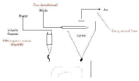

A weigh-feeder system measures a fine solid, a slurry, and a volatile organic into a mixer. The expensive volatile organic quickly evaporates. It is used in such small quantities that it must be carefully measured because it affects final product quality: too much and the concentrated organic could cause skin and eye irritations; too little and only the waxy smell of the solid will be present. The slurry tends to plug the feed nozzle. Sometimes, the fine-solid particle distribution ranges from dust to pellets; this variation sometimes blinds the dust collector downstream and, alternatively, plugs the pneumatic conveyor pick-up point because the solid particles are too large, or fine particles agglomerate, pick up moisture and seal up the pick-up point (Figure 1). How can we improve reliability of the system?
Figure 2. Block diagram of weigh-feeder system and troubles. (Click to enlarge.)
Install two cyclones
From your description, I found several problems that need to be solved to operate this process smoothly. I identified the following problems from the sketch and the description: 1.) variations in the particle size in the distribution of solids are causing pluggage of the bottom nozzle by two possible mechanism: with bigger particles blocking the nozzle or by bridge formation with fines; 2) the solid appears to be hygroscopic — it picks up moisture from the atmosphere and seals up the nozzle; 3) slurry is to plug the feed nozzle in its weigh tank; 4) and the volatile organic liquid is evaporating at a faster rate than expected by the system designers.
Based on these observations, I recommend the following improvements which I hope will improve the operational reliability: The present configuration for handling solids won’t work. To avoid choking the cyclone bottom nozzle, design two new cyclones, in series, for two different particle sizes. The bigger particles will be separated in first cyclone and fines in the second one. These sizes must be carefully estimated.
Without knowing what the distribution looks like, it will be necessary to define an “average” particle diameter for each cyclone that minimizes bridging. Also, the size should be for several days of running time so that production upsets are averaged into the analysis.
Managing the moisture problem will be a challenge. A small rotary feeder in the bottom nozzle of cyclone should help prevent uncontrolled contact of moisture and the particles. Pneumatic vibrators, thumpers or air blasters should be installed upstream of the rotary valves as a hedge against bridge formation with fines. The conveying air should be cooled sufficiently to avoid moisture content which can affect the free flowability of the material. You may want to go back to the air dryer and upgrade to a desiccant dryer. If possible, nitrogen gas might be considered for conveying. Since this is an expensive idea, perhaps, a small amount of nitrogen flow could be put introduced upstream of rotary feeders through rotometer. In this way, a trickle of nitrogen might reduce plugging problems in the air locks.
Because the second cyclone will collect the finer particles, you will want to verify the downstream filters on the pneumatic conveying system. This type of system, and variations in the particle size produced, may result in an unexpected carry-over.
The plugging of the slurry nozzle is a difficult problem. Perhaps a screw feeder would be an alternative. (Making it easy to change out the nozzle might be the only alternative.)
To reduce evaporation losses with the organic consider reducing the quantity to a minimum. Changing to a small plunger reciprocating pump with continuous flow could work. Chilling the organic to reduce its vapor pressure could work if chill water is available. Lowering the temperature should be checked to assure that viscosity or phase separation doesn’t become a problem. The vessel, where-in all three are mixed should be closed. Also a properly designed padding should be added to reduce vapor content over the mixing solid and liquid. Sealing the tank also will reduce any chance of contamination.

Incorporate a vibrating device under the powder cyclone to avoid plugs. Reduce the evaporation of the volatile organic by adding a retardant. I suggest something like dipropylene glycol. To reduce the cost of the retardant, maybe add it using a dosing device. I would use an air atomizer, or something like it, to distribute the retardant evenly over the solid in the mixer below the weigh system.
