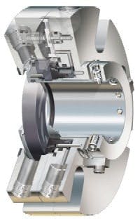

A typical gas seal design will use hydrodynamic lift-off to separate the rotary and stationary seal faces. Spiral grooves in the rotary seal face collect the gas. As the seal rotates, gas is compressed towards the end of the groove creating an opening pressure. This pressure exerts an opening force greater than closing force, separating the seal faces. This slight separation allows the gas to flow across the seal faces. Thus, the seal faces ride on a pressurized, gaseous fluid film (Figure 1).
Figure 1. A cutaway drawing of a compact gas seal.

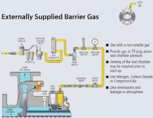

For a successful gas seal installation, clean, dry barrier gas should be supplied to the gas seal. Pressure must be regulated within two limits: above the maximum stuffing box pressure and below the maximum system design pressure. Proper pressure regulation ensures that the seal faces are lubricated with a gas barrier, while maintaining a clean environment between the faces.
Pressurized gas seal should be from a reliable source and set at a pressure that’s regulated to at least 15 psig (1 Bar) above the maximum sealing pressure in the equipment. While older designs use large control panels to regulate pressure at maximum pressure levels, newer designs are available that actively regulate gas pressure with respect to changing stuffing box pressure to ensure low gas consumption and maximize reliability. Typical gas usage is shown in Figure 3 and is often well below 1.0 SCFH of consumption.
Figure 3. Plan 74 isolates process fluid, thereby preventing emissions.
The compressed gas should be dry and filtered to ensure reliable operation. Design of the gas panel should allow for routine filter maintenance with minimum intrusion into production. A coarse and fine filter system is the accepted practice as it allows easy filtration down to two microns (Figure 4). Upon seal installation, blow out the gas supply lines downstream from the filter system to eliminate any tramp metal in the lines.
Figure 4. Options are shown for venting gas that may accumulate during downtime.

Seals will ingest small amounts of compressed gas during operation. Barrier gas will migrate past the inboard seal faces into a process system by design. Unfortunately, seals are often continuously pressurized. During a shutdown gas flows into the piping system. Unless this gas is vented properly, a condition may occur where the amount of gas is in excess of gas entrainment capability of the pump, process piping, or system design. As a result, the pump can become vapor locked or can experience severe cavitation. The solution is common sense. Vent the excess gas to a lower pressure area than that of the pump stuffing box, making certain to by-pass the inlet piping to the pump.
If all possible causes are exhausted, and the source appears to be inert barrier gas (gas entrainment) from the gas seal, a bleed line will have to be installed. System design and operating pressures will dictate the optimum destination for bleed off. Ideally, a small vent line (1/2 in. min) will typically be connected from the seal gland or the equipment stuffing box connection to one of the following:
  • To the top of the suction tank; or
  • To the final delivery point of the process fluid if it is at a lower pressure than the pump stuffing box.
In the event a bleed off line isn’t installed, excess gas must be bled off the pump discharge (upstream of the discharge check valve) to a lower pressure location prior to pump start-up. The gas has the tendency to accumulate at the highest point in the system. Provided a bleed valve is installed, the gas can be bled through the bleed valve and shut off when fluid flow is evident. The pump can be started after bleeding is complete. The vent, when appropriate, may be used as a continuous vent or for recirculation.
Where a spare pump is on standby and under process pressure the barrier gas has the potential of pressurizing the spare pump. The amount of gas may exceed the pump capability. The same venting procedure, as above, should be followed.
Newer designs automatically track process pressure and maintain the optimum pressure differential between barrier gas pressure and stuffing box pressure which minimizes gas ingestion. Older designs have their gas set to handle maximum or worst case pressure, which at shutdown increases the likelihood of gas entrainment.
