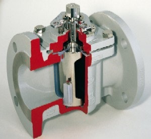

Flowserve learned that Bechtel was favoring top-entry style ball valves for the bulges. The Flowserve team instead believed that Flowserve high-performance plug valves would be a more effective solution. “Plug valves work better in slurries than ball valves,” says Mark Shaw, western regional manager, Flowserve Flow Control. “Plug valves have adjustable positive sealing upstream and downstream and 360° around the top of the plug. By design, plug valves have no cavities where material can collect and/or solidify. Because plug valves also have more than doubled the sealing area of a typical ball valve, they are a more effective solution for slurry handling.”
At the time, Flowserve’s only in-house candidate for the WTP bulge valves was the Flowserve Durco G4 plug valve (Figure 2).
Figure 2. Plug valves have more sealing area than ball valves, making them superior in slurry service.
While the G4 had a successful 35-year history of service in tough slurry applications and had been used in nuclear power applications with nuclear N-stamp requirements, its older design didn’t allow for remote repair and therefore did not meet the requirements of the WTP project.
