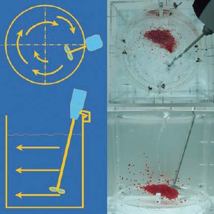

Now, the difficult part of understanding mixing: a strong vortex isn’t necessarily a good thing. If the shaft of the mixer, when viewed from above, points straight across the tank, strong rotational flow will occur. With this installation, a vortex will form around the rotating shaft. Mixers typically rotate clockwise when looking from behind the motor, so that rotation is transferred to the fluid. The result is clockwise rotational flow in the tank. What is wrong with rotational flow? If the objective of a process step is to add a powdered ingredient to the liquid, strong surface motion with a vortex may help. If the object is to achieve uniform mixing from the top to the bottom of the tank, rotational flow isn’t the best solution.
Figure 2. Particles are poorly distributed on one side of the tank with the shaft aimed straight across the tank.
Figure 2 shows the drawbacks of rotational motion. While it looks as if the surface of the fluid is moving well, particles in the top-view photograph swirl around the outside of the tank. The side-view photo shows that most of the settling particles are on one side of the tank. The side-view photo also shows a small vortex on the surface above the impeller location. Unfortunately, any still picture of agitation shows only a part of the story, because agitation is an active process. These still photos don’t adequately show the rotational swirl and random patterns of the actual mixing.

The side view photo shows a strong vortex leading from the surface almost down to the impeller. Here’s a bit of irony: the stronger the vortex becomes, the poorer the mixing. Sometimes the vortex helps draw powders from the surface, but it won’t mix them well. This enhanced-motion position also may provide mixing for more viscous fluids.
