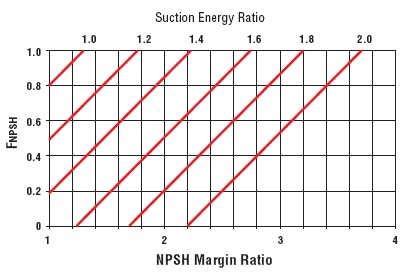

The net positive suction head (NPSH) margin and the SE ratio also affect pump performance and reliability. Figure 6 illustrates the relationship between reliability (FNPSH), NPSH margin ratio, and SE ratio. Suction Energy is a measure of the potential for damaging suction recirculation whereas NPSH Margin Ratio (NPSH available/NPSH required) is a measure of the ability to suppress suction recirculation damage (see sidebar). Most process pumps are designed with relatively low values of Suction Energy and have values for FNPSH of 1.
Figure 6. A powerhouse application shows pumps operating at a wide range of conditions.
These reliability factors can be used in evaluating the benefits of making changes to a pumping system. In comparing options for a particular application the “relative reliability index” or RI , should be evaluated. Use the following equation based on the factors from Figures 3-6:
RI = Fd × Fn × Fq × FNPSH
Because of the nature of the individual factors, the RI will be between 0 and 1 and will be less than these factors. In most cases reducing energy consumption also lowers maintenance expense; however this is not always the case. For example, reducing impeller diameter can increase recirculation in the suction; this leads to pump damage (Figure 5).
