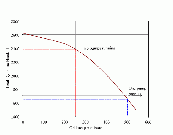

In its hydrotreater (hydrogenation) unit, two identical eight-stage centrifugal pumps originally were installed: one for normal operation and the other as a spare. By operating both pumps, it’s possible to increase the available head because each pump has a lower flow rate. As the pump curve (Figure 1) shows, dropping the flow rate from 500 gpm through one pump to 250 gpm through each pump raises the total dynamic head (TDH) generated from 1,647 ft. to 2,342 ft.
Figure 1. Using two identical pumps to handle the same flow significantly boosts total dynamic head generated. (click to enlarge)
