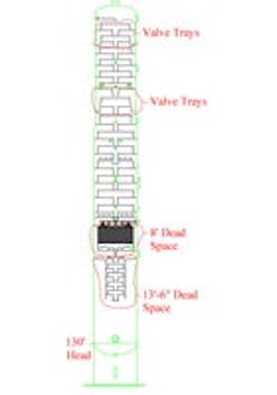

Here are some of my guidelines and design criteria for using water for pressure testing. Many of these points are especially important in dealing with tall vessels, such as the 130-ft. tall distillation column depicted in Figure 1. There, the water height adds 56 psi of static pressure on the bottom.

The tower in Figure 1 poses five potential trouble spots for a hydrostatic pressure test: two sections of valve trays, two sections with internal partitions creating potential dead spots, as well as the extra 56 psi of static pressure on the bottom.
Restricting fill and drain rates to appropriate values will prevent damage to the valve trays. The dead spots require either internal venting or external venting through nozzles to prevent the relatively weak internals from bearing excessive load (when filling) or having a partial vacuum pulled (when draining). It’s crucial to account for the static head from the vessel height in setting MAWP and test pressures. The vessel was successfully pressure tested with all internals in place by taking all factors into account and allowing for them.
