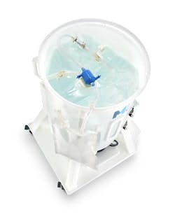

Figure 2. Mixer features magnetically driven impeller and electronic drive system. Source: Millipore.

Described by the company as the only single-use mixers that are part of an integrated solution, Mobius MIX100, MIX200 and MIX500 systems include, respectively, a 100-l, 200-l or 500-l container with a magnetically driven impeller and an electronic drive unit (Figure 2). A variety of filter, connector and tubing options enable tailoring to a specific application and environment, including sterile interfaces, from fermentation to final fill. The single-use mixing systems also are available with stainless-steel carriers with and without external-heat exchange jackets.
