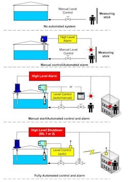

Figure 1. Automation found in tank farms and terminals can range from none whatsoever to full.

Estimating the likelihood of overfill is complicated by the combination of manual and automated control that's necessary as equipment is started up and operated. Figure 1 shows the range of automation commonly found in tank farms and terminals. The degree of automation generally relates to the expected rate of level rise and operator workload. Automated control and safety systems typically are added when control changes must be made too often to be continuously managed by the operator or when work complexity has increased to where the expected human error rate is no longer acceptable.
