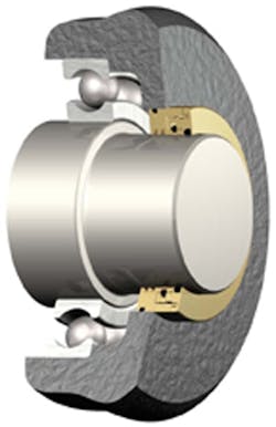

Bearing Isolator
Figure 1. Maze-like internal structure collects and ejects contaminants before they can intrude.
In general, dynamic radial seals create a barrier between surfaces in relative motion (one usually is stationary while the other rotates). These seals -- more often than not made from nitrile rubber -- may feature a plain, wave or helix lip design. In many cases, a garter spring holds the primary sealing lip in position and also promotes oil retention. Standard seals usually incorporate a simple L-shaped shell with the sealing material bonded to it; others also may include an inner shell to help protect the lip from damage or distortion during installation.
Bearing isolators or labyrinth-type seals (Figure 1) provide highly effective exclusion capabilities. Instead of a contacting radial lip element, these seals rely on a labyrinth or maze-like internal structure to collect and eject contaminants before they can intrude. Designs typically integrate a stator pressed into the housing and a rotor fixed to and turning with the shaft. The two components are locked together for easier assembly and to prevent damage during handling. Standard versions usually will incorporate polytetrafluoroethylene (PTFE) for the structural body material and fluoroelastomer O-rings to promote high chemical and temperature resistance.
