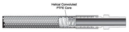

Convoluted Cores -- Figure 3. Helical design (top) has a single
spiral while annular design (bottom) uses a series of
connected rings.

Convoluted cores come in two types — helical and annular. The helical design, found primarily in fluoropolymer cores, is a single convolution that spirals down the length of the hose (Figure 3 top). The annular design, typical in metal cores, consists of a series of connected rings (Figure 3 bottom).
Helical convolutions promote better flow downstream than annular ones; so, choose a helical design when flow maintenance and drainability are important. Annular metal cores come with deep convolutions and so provide maximum flexibility. However, convoluted metal hoses don't suit operations with repetitive movements because such movements can cause metal fatigue and breakage.
