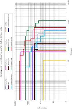

PRESSURE VERSUS FLOW CAPABILITIES
Figure 3. Special designs may exceed the values shown. Courtesy of Hydraulic Institute, www.pumps.org, Parsippany, N.J.

Figure 3 depicts the pressure-versus-flow capabilities of types of rotary pumps. The ranges and the maximum values shown aren't absolute; custom designs with alternate speeds, clearances or special materials may exceed these values. To learn more, visit the Hydraulic Institute at www.pumps.org.
