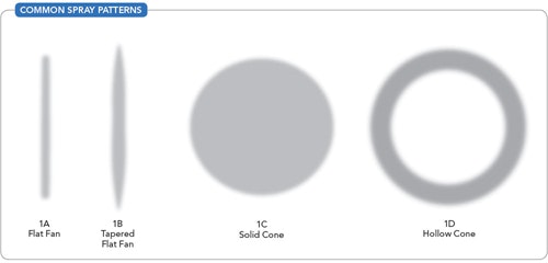

Common Spray Patterns
Figure 1. Nozzles use internal elements and flow passages to create the desired pattern.
Many applications require a combination of these functions to yield the desired results.
One useful way to classify spray nozzles is on the basis of their energy input, because all require energy to overcome surface tension to produce a dispersion of drops. Some nozzles rely on kinetic energy — in the form of high-velocity liquid in a single-fluid (hydraulic) nozzle or high-velocity gas in a two-fluid (atomizing gas or air atomized) nozzle. Other nozzles use mechanical energy in the form of vibration in an ultrasonic nozzle or rotation in a rotary atomizer wheel. These four types of nozzles account for the vast majority of atomizing technology used at process plants.
Single-fluid nozzle. This is the most common nozzle. A precision device, it comes in a wide variety of materials, including metals, plastics and ceramics. Fluid pressure results in a high-velocity stream of liquid at the nozzle outlet. The nozzle’s design provides a specific spray angle and spray pattern; these are the first two characteristics to use to narrow the choice of nozzles for an application. The effective spray angle is the included angle of the visible boundary of the spray at the nozzle tip. The nozzle’s internal components and liquid passages are used to produce a variety of spray shapes, which are known as patterns or footprints, and liquid distributions. Figure 1 depicts some common spray patterns.

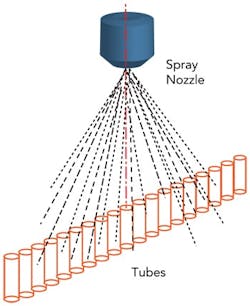

It’s also important to consider quantitative liquid distribution, which is called liquid flux distribution (LFD) or patternation (Figure 2). Comparing LFD data from different nozzles is useful in determining the best nozzle to achieve a uniform application of material. An array of tubes (like rain gauges) collects liquid across a spray plume (Figure 3) and then the local flux distribution is calculated as gpm/ft2 or m3/sec-m2. The LFD data, for example, allow direct comparison of the uniformity of different solid-cone nozzles so you objectively can select the most suitable nozzle based on a specific flow, spray angle, nozzle spacing, arrangement and nozzle capacity.
Liquid Collection Tube Array
Figure 3. Measurement of liquid that goes into each tube allows calculation of liquid flux distribution.
