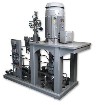

Centrifugal pumps usually handle most liquid pumping services at plants. Indeed, the pumps, which come in vertical and horizontal configurations (Figures 1 and 2), are ubiquitous at most sites. However, such pumps do not suit highly viscous liquids; these liquids require positive displacement pumps. Unfortunately, some engineers still specify positive displacement pumps for many water services and some medium viscosity liquids in the hope of, say, greater flexibility or operational advantages. In most such cases, though, variable-speed centrifugal pumps are better choices.
Vertical Pump
Figure 1. This high-speed centrifugal pump conforms to the API-610 standard and is driven by an electric motor through a gear unit. Source: Sundyne.
