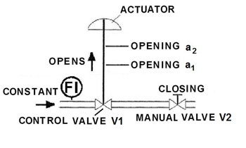

Figure 1. Maintaining a constant flow rate while adjusting the manual valve enables determination of opening a2.

When designing a plant, the traditional method to size a control valve consists of allocating to it 25–50% of the dynamic pressure drop of the corresponding flow path or, alternatively, an absolute pressure drop; its opening is fixed to, say, between 60% and 75%. This original design opening constitutes a2 and thus allows calculating ∆HL; also the original pressure drop may be used directly. Nevertheless, to determine the maximum avoidable pressure loss — and thus maximum potential energy savings —the control valve should be as wide open as possible while still achieving good controllability. The value of opening a2 can be found by using the configuration shown in Figure 1,while maintaining a constant flow rate (monitored, e.g., by a clamp-on flow meter)and applying the following procedure: Throttle manual valve V2; the control valve V1 will open to compensate for the reduced pressure at its outlet port. (In other words, the pressure loss of control valve V1 shifts partially to valve V2 and, as long as the flow rate does not decrease, the sum of the pressure losses of V1 and V2 remains constant, i.e., the operating duty point does not change.)Repeat this procedure several times in the field until controllability deteriorates. Select the opening just before this happens asa2 [2].
