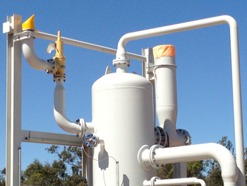

Reducers provide a change in pipe diameter. They are either concentric (Figure 1) or eccentric. Concentric reducers retain the existing pipe centerline, while eccentric ones shift the centerline. Eccentric reducers are useful, for example, to maintain elevation bottom-of-piping (BOP) in a piping system or with flat-side-up (FSU) in a pump suction to avoid problems such as gas pockets.
Reducers
Figure 1. This piping system uses a number of concentric reducers.
