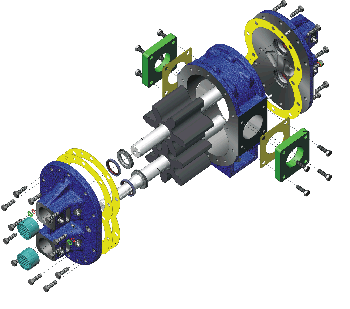

In external gear pumps, a casing encloses two meshing gears with external teeth (Figure 1). A rotating shaft drives one gear, which then moves the other gear. The turning of the gears causes liquid to enter the inlet (suction) port, flow into and around the outer periphery of the gears, and then exit through the outlet (discharge) port. The size of the cavity (volume) between the teeth and the speed of the gears regulates this flow. The amount of liquid that slips back to the inlet port also affects the discharge flow. The degree of slip depends upon the side clearance of the gears to the casing, the peripheral clearance of the gear and bore in the casing, gear-to-gear clearance, developed pressure and the viscosity of the liquid — the lower the viscosity, the greater the slippage.
External Gear Pump
Figure 1. Both gears have external teeth. Source: NAPCO Pump.
