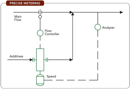

An alternative combines both open-loop and closed-loop control (Figure 1). The open-loop uses feedforward from a flow controller to set the metering pump. The closed-loop uses feedback from a composition analyzer to regulate motor speed. This system separately adjusts for rate and composition variations.
Precise Metering
Figure 1. Combining open-loop and closed-loop approaches can enable accurate dosing.
Each loop could have a separate gain and lag built in. This results in a system capable of much more precise control and smaller variations in additive content.
The rapid response to rate changes reduces the effect of the analyzer’s long response times to composition changes. The analyzer only serves to compensate for composition disturbances. Therefore, rate changes take effect immediately, not with a long delay.
