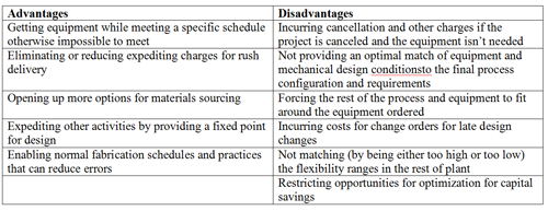

[pullquote] Long delivery times easily can imperil plant projects and maintenance. Specialized equipment may have relatively few reliable manufacturers — and, thus, involve lengthy lead times. Meanwhile, industry consolidation has reduced the number of capable suppliers for some types of commonplace equipment (pumps, for example), again impacting the speed of delivery. So, ordering equipment before a plant knows exactly what’s needed may offer advantages. However, early ordering comes with tradeoffs. Table 1 lists some of the benefits and concerns.
The Tradeoffs
Table 1. Early ordering poses a number of important benefits and concerns.
Early ordering has the greatest value and, thus, is most compelling when it’s the only way to adhere to the project’s schedule. If multiple procurement, shipping, manufacturing and assembly steps are required in sequence, as they often are, schedules may be impossible to compress beyond some point. Many projects recognize this by identifying specific items with long-lead-time delivery. Major machinery — e.g., large compressors, solids handling and other equipment requiring precision moving parts — frequently falls into this category. Delivery of these items may stretch to 24 months or longer after order.
