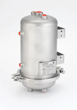

Better Option
A two-part vessel is part of the latest development in water and oil API plan 53a barrier-fluid-management systems, and is aimed at environments that require a higher level of cleanliness. Its design allows the lower section to be quickly and easily opened, enabling inspection and cleaning, if needed, of the internal cavity (Figure 4). It has been shown that a two-part vessel design in an API Plan 53a arrangement, coupled with a scheduled inspection and cleaning program, can prevent contamination from the process and bacterial growth.

Such a design drastically reduces the chances of dirt and bacteria build-up within the internal cavity while maintaining all the water- and cost-saving features of a standard system.
This option helps avoid product contamination, reducing the chance of product rejection or even recall. In addition, a two-part vessel can be manufactured to minimize the possibility of bug traps by using filler welds, a custom-designed gasket and a sediment pipe to ensure particulates aren’t introduced into the thermosyphon stream.
Two-Part Vessel
Figure 4. Removable bottom section enables quick inspection for contamination and facilitates any needed cleaning.
The seal feed line usually is positioned at the lowest point of the vessel. However, it is far more effective to introduce the sediment pipe feed higher up the vessel, which greatly reduces the risk of particulates re-entering the barrier fluid line and, ultimately, the product.
Other features also can help maintain a high level of cleanliness. For instance, a clean-in-place (CIP) attachment can ensure the internal surfaces of the vessel are clean and free from unwanted deposits. This is a special fitting that screws into the top of the two-part vessel and includes a CIP ball. In cleaning operations, the appropriate fluid is pumped through the attachment and the ball gives 360° coverage, at pressure, around the internal surfaces of the vessel.
Through correct implementation of a two-part vessel as part of API Plan 53a, a processor can reduce the potential for product contamination and increase reliability while achieving greater efficiency and cost savings.
