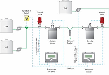

Precision Batching
Figure 1. Successful and trouble-free operation depends upon careful equipment selection.

Control valves can play a huge role in helping a process plant improve productivity and efficiency. In most cases, ensuring an efficient and successful operation such as batching (Figure 1) requires a precise combination of valves, meters, sensors and other equipment.
