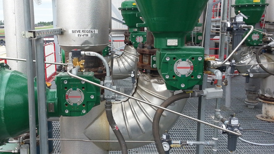

Many plants rely on adsorption to remove or separate specific components of a liquid or gaseous mixture. This mass transfer process typically involves multiple valves (Figure 1). Stroking frequency of those valves can exceed 60,000 cycles per year and maintaining industrial gas purity and efficiency requires tight shutoff to Class VI.
Adsorption Process
Figure 1. Reliable operation requires multiple specialty valves designed for high cycles.
Many problems occur from using the wrong valves. Poorly performing valves can lead to increased maintenance, unit trips and decreased efficiency. For example, when surveying ethanol producers from around the world, some of the most commonly reported maintenance problems related to adsorption include:
• poor control and reduced cycle life due to oversized butterfly valves;
• accelerated bearing wear, often seen after only a few months;
• multiple mechanical failures because of inferior valve-actuator-positioner linkages; and
• inadequate performance from low-quality valve positioners in both the adsorption and regeneration cycles.
Improper selection of control valve assemblies for adsorption processes can cause unscheduled downtime. During this downtime, a typical 50-million-gal/yr ethanol facility can suffer more than $10,000/hr in lost revenue.

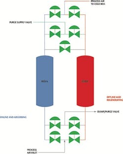

Figure 2. Simple pressure-swing adsorption process switches between two beds — with one online while the other is regenerating.
Figure 2 shows a simple PSA scheme for air separation; it uses two beds of molecular sieves, with one adsorbing and the other regenerating at any given time. An air separation process primarily aims to separate oxygen or nitrogen. During the production step, air goes into a cylinder containing beads of adsorbent material at pressure. During the regeneration step, a small amount of nitrogen or oxygen flushes the waste gas through an exhaust port, preparing the vessel for another production cycle.

Switching valve. It cycles the beds between online and offline. This valve is very important because, if incorrectly controlled, it can fluidize or fluff the adsorption beds, causing damage to the adsorbent materials and the bed itself. Such fluffing can be a very expensive problem and must be prevented.
Cycle times depend on the regeneration method. In the TSA process, the cycle time is around eight hours. In contrast, the PSA and VPSA switching processes take one to three minutes. The marked difference reflects how much faster pressure changes can take place than temperature ones.
Dump/purge valve. This removes impurities from the process. Because the impurities leave as off-gas, this often is called the off-gas process.
Feed gas valve. It introduces feed gas (air, hydrogen, biogas, etc.) into the clean adsorbent bed. It opens simultaneously with the product valve to ensure the feed gas passes through the bed, allowing the bed to adsorb impurities to make the finished product.
Purge supply valve. This enables purge gas to enter the beds by connecting bed A to bed B. Gas then flows from the higher pressurized bed into the lower pressurized one. Keeping pressure in the lower pressurized bed as low as possible minimizes the impurity partial pressure and maximizes adsorbent regeneration. This valve also can perform equalization between the beds.
Product/repressurization valve. It permits the final product to pass through the top of the adsorption beds and then into product storage tanks. This valve works in conjunction with the feed gas valve so that feed gas goes through the bed and gets treated before the final product leaves the vessel. It also can perform equalization between the beds.
