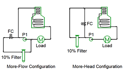

Figure 1 shows a simple hot oil system with two possible slipstream systems: a more-flow (MF) configuration (left) and a more-head (MH) configuration (right). Figure 1 focuses on the slipstream. The main circulating flow to supply oil to the thermal load has its own independent flow control system (not shown).
For the MF configuration, the slipstream goes from the pump discharge to the pump suction. As long as the circulating loop has a higher pressure drop than the filter, the only effect on the pump is a required higher flow rate. The discharge pressure of the pump can remain the same. In this system, the pressure drop in the main circulating loop sets the maximum available pressure drop for the filter. The hydraulics of the main loop potentially limit filter sizing and life.

Figure 1. The same size slipstream doesn’t mean the same size power demand.
For the MH configuration, the slipstream splits from the pump suction, goes through the filter and then returns to the main flow. The pump capacity needed doesn’t change but the pump discharge pressure must increase by the pressure drop through the filter.

To add detail to the example, let’s propose a reasonable pressure drop of 12 psi across the filter element to control filter operating costs and a pressure drop of 80 psi across the main loop in the hot oil system. The slipstream rate is 10% of the total flow required to deliver the heat load.
Using the MF system, the pump discharge pressure stays the same and the flow rate rises by 10%. The pump power goes up by 10%.
With the MH system, the total pressure drop increases to 92 psi from 80 psi. This is a 15% boost in discharge head. The pump flow rate stays the same but the pump power rises by 15%.
Most hot oil systems follow this pattern. The percent change in pressure drop required for a reasonable filter element life will exceed the percent change in flow. This is because most hot oil systems have relatively low slipstream rates and filter applications generally need relatively high pressure drops.
As the slipstream fraction goes up, the advantage shifts from the MF to the MH option in new systems. To go back to the example, shifting to a 30% slip stream rate increases the power demand of MF to +30% while MH’s remains +15%.
