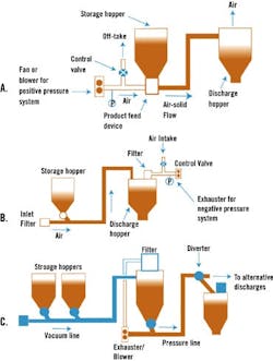

Figure 1. Choose Wisely
The choice of a positive pressure (A), vacuum (B) or combined (C) system will be defined by product feeding and/or discharge requirements.
Multipoint feeding of a positive pressure conveying system generally is not recommended. The air loss from a single feeder subject to leakage can be a significant proportion of that required for conveying the product. The loss from a number of feeders, if they are not isolated by additional valves, could be very high.
The air loss from a number of feeding points could be difficult to estimate accurately. So, the air available for conveying, which is a crucial requirement, could not be guaranteed. Apart from problems associated with having too little or too much air for conveying the product, the loss of a large quantity of air from a number of feeding points also would represent a very significant energy loss for the system.
Negative pressure systems
A vacuum conveying system is not the answer if multipoint discharging of product is needed, since such a system requires complex arrangement of pipework and isolating valves. These valves are sometimes found in low-pressure systems where ductwork is used. Valves in the ductwork, however, have to seal effectively, otherwise the air leakage into the system will adversely affect conveying.
If air leaks into a negative pressure system, it will alter the balance of conveying air velocities along the length of the pipeline. If air ingress is not accounted for in the air mover spec, the line is likely to block. If the air mover is over-rated to allow for air leakage, product flow rate will be reduced. Air ingress is likely to occur along a pipeline at flexible sections such as those used in off-loading systems, particularly if the conveyed product is erosive and the joint is hard metal or ceramic material.
Combined systems
Operating pressures also will differ. With a Roots-type blower, for example, a pressure ratio of 2:1 is generally considered the upper operating limit. Thus for a positive pressure system the maximum delivery pressure is about 1 bar gauge. For a negative pressure system the maximum exhaust pressure is about -0.5 bar gauge. For a combined system, the limit on pressures is approximately 0.4 bar gauge on blowing and -0.3 bar gauge on vacuum.
Since the two parts of the combined system operate at different absolute pressures, the pipelines likely will be different diameters. Figure 2 illustrates this point.

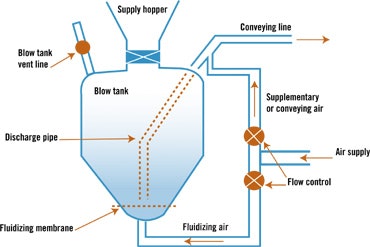

Figure 3. Blow Tanks Batch It
Single blow tank systems operate in a batch mode. Of all system components, blow tanks are probably least understood in terms of operation and control.
It is important to realize that to obtain a required time averaged mean value, the pipeline bore and air requirements must be based on the steady-state value achieved during the conveying cycle. If the desired product flow rate is not being achieved, consider means of increasing the ratio of the time-averaged mean to steady state values. Assess the times required for pressurizing, depressurizing and venting, valving and possible changes in operating procedures and conveying conditions.
Proportioning the air supply between the fluidizing and supplementary air lines controls the discharge rate of a blow tank. If insufficient product is being fed into a pipeline, the proportion of the total air supply that is directed to the blow tank should be increased. If too much product is being fed into a pipeline, this proportion should be reduced.
Figure 4. Blow, No Blow
For a given time-averaged mean value of product flow rate to be obtained from a blow tank, a very much higher value must be achieved during the steady-state portion of the cycle.
The discharge limit of the blow tank will be reached when all the air is directed to the tank. A further increase in product flow rate can be achieved by boosting the volumetric flow rate of the air, but this will have an adverse effect on the conveying of the product in the pipeline. The alternative is to increase the diameter of the blow-tank discharge pipe.
If a blow tank is to convey a product over a range of distances, the proportions of the air will change according to the distance conveyed. If this is not taken into account, the pipeline will be underutilized for shorter distances, and may block on longer distances. Here, a pressure gauge in the air supply line is particularly useful, for it can ensure the product flow rate through the pipeline is always the maximum that can be conveyed with the given air supply, regardless of conveying distance.
An automatic controller proportions the total air supply between the blow tank and the supplementary line. Control is usually based on pressure signals since, assuming that the blower or compressor operates within a prescribed range, any change in conveying rate, and hence phase density, will be reflected in a change of operating pressure.
If too much product is discharged into the conveying line, the pressure will increase and so the modulating valve will decrease the proportion of air passing to the blow tank to compensate. If the pressure drop across the conveying line is low, the modulating valve will reduce the supplementary air and so allow more air to pass to the blow tank and hence increase its discharge.

Both the blinding of a fluidizing membrane and a restriction in the discharge pipe will add to the pressure drop across a blow tank. If the pressure drop across the product feeder increases, the pressure drop available for conveying the product in the pipeline will decrease and, so, cut conveying capacity.
Part of the blow tank pressure drop occurs in discharging the product from the blow tank. This is particularly a problem in top-discharge blow tanks requiring a long discharge line. The conveying air should be introduced as close to the tank as possible to minimize this pressure drop. In a tall blow tank it may be necessary to bring the discharge line out through the side to reduce its length.
The performance of a blow tank can be monitored quite easily by pressure gauges. A pressure gauge installed in the supplementary air supply line will effectively give a measure of the conveying-line pressure drop, and hence the use of the pipeline in conveying the product. A pressure gauge in the blow tank will then give an indication of the pressure drop across the blow-tank discharge line. If the blow tank has a fluidizing membrane, a pressure gauge in the air supply line to the blow tank will help monitor the state of the membrane.
With top-discharge blow tanks, there is also a minimum discharge limit, which relates to the fluidization air velocity in the discharge line.
If an attempt is made to convey a product at a low velocity from a top-discharge blow tank with only a small proportion of the air flow rate directed to the blow tank, the blow tank could "stall" and cease to discharge product into the conveying line. This is because the air velocity in the blow-tank discharge line will be very much lower than that at the product pick-up point. For a product having poor permeability and air retention properties, this could result in a blockage of the discharge pipe. If this occurs, use a smaller diameter discharge pipe.
Granular products can cause discharge problems from a top-discharge blow tank. Air permeates very easily through these products and it is possible that insufficient resistance will be built up to discharge the product. Bottom-discharge blow tanks are generally recommended for granular products.
Because of their high permeability, granular products require a higher proportion of air directed to the blow tank for a given rate of discharge than that needed for powders.
