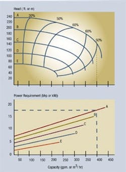

Electric motors operate at their peak power factor and efficiency when fully loaded. So, you do not want to purchase a motor that is too big; common sense dictates that one that is too small is even worse. A few simple steps will help you select the right motor for your centrifugal pump application.Let's assume that the pump performance curve shown in the figure represents the pump that needs a motor. The first thing we must do is decide what diameter impeller to use. The figure shows impeller diameters from "A" to "E." The curves are marked with letters rather than numbers so that we can work the examples in either metric or English units.For this example we will use impeller size "A." To determine the maximum capacity for your pump, select the last efficiency line at the right-hand side of the top curve. For this particular pump, that would be the 50% line. You don't want to read off the line any further to the right, since the pump will likely cavitate in this region of operation.The capacity at this point is 400 gpm or m3/hr. Using the bottom curve, determine the energy required by the pump in either brake horsepower (bhp) or kilowatts by finding the point for 400 gpm or m3/hr for impeller size "A." According to the figure, the pump motor will use about 17 bhp or kW at this capacity.The specific gravity of the fluid being pumped is assumed to be 1 (like fresh water). Electric motors are sized considering the specific gravity of the liquid being pumped. If a low-specific-gravity pump is tested with water, or any higher-specific-gravity fluid, the increase in motor amperage could burn out the motor.If the actual fluid has a higher or lower specific gravity than water, we must multiply the number on the Y-axis of the bottom curve by the specific gravity of the fluid to get the correct energy requirement for the application.If the pump is sized correctly, it will run within 10% of its best efficiency point. For impeller size "A," that would be about 325 gpm or m3/hr (as shown in the figure). So, we can take advantage of the pump service factor to give us the needed horsepower should the pump occasionally run at the maximum capacity (400 gpm or m3/hr) or get into any other temporary overload condition, such as starting while rotating backward.Service factor ratings

The pump performance curve shows that the maximum capacity for impeller size "A" is 400 gpm or m3/hr. A motor for this pump should be rated at 17 bhp or kW.API requirements
