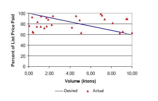

Deal management
Deal management involves structuring workflow to ensure profitable actions are taken. One example is managing of quotes. A key aspect is funneling all quotes before being sent to customers through the same channel for approval to provide a check on their profitability. Deal management also includes checks on customer contract compliance. For example, a given customer may have been quoted prices assuming certain minimum volume commitments. If that volume is not being ordered, then charging higher prices is warranted. Figure 4 depicts a common scenario. A manufacturer is willing to offer a greater discount from list price the more a customer purchases, as indicated by the line. However, because of the difficulty in managing data, firms end up discounting in the random manner shown by the discrete data points. Deal management, by addressing such inconsistencies, can help improve profitability when market conditions pressure margins downward.
Fig. 4 Desired versus actual price
