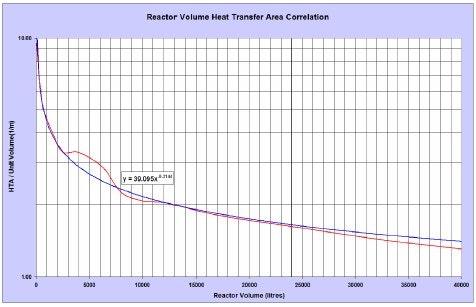

Reactor parameters
The heat-transfer-area/reactor-volume ratio increases as the reactor size decreases (Figure 3). This needs to be considered carefully during scaleup and underscores the importance of correctly matching reactor size to batch size. Partially filled reactors not only reduce the heat-transfer area but can cause mixing problems and exothermic reaction instability.
