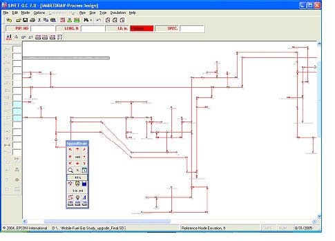

Revamped fuel-gas system
Sometimes you will actually know there is a fluid-flow-related problem but can’t quantify the magnitude of the potential impact. This was the case for the fuel gas system at Shell Chemical’s olefins production facility near Mobile, Ala.
The original design of having two blend drums to collect offgases from process units was changed from a parallel to a series flow sometime in the past by the previous owner of the facility — so that only one gas analyzer had to be purchased and installed to meet regulatory requirements for fuel gas being fed to the plant’s steam boilers. This objective was accomplished, but the original system’s fluid flow path was more than doubled through the plant — resulting in a system pressure drop of 32.5 psi from the natural-gas feed point (82.5 psig) to the farthest furnace fed by the fuel gas system (#2 Crude Heater, 50 psig). Plant management, concerned that a slated capital-improvement project could be negatively impacted by a shortage of natural gas due to that system, commissioned an in-depth fluid flow study.
A pipeline simulation model was first developed for the fuel gas system to match current operations. This quantitative fluid-flow analysis (including all lengths, diameters, valves, fittings, etc.) demonstrated that there was approximately a 5-psi additional drop in the system’s lowest-elevation piping from field data versus what was predicted in the pipeline simulation model. This was attributed to a build-up of liquids or solids settling into this low spot in the piping system. To help prevent this problem from occurring in the future, a blowdown trap was added at the lowest point in the fuel gas system.
As a result of the fluid flow analysis, the first recommendation was to re-establish the original parallel flow design of the fuel gas system. This would then send the offgases to two blend vessels at opposite ends of the plant to restore system pressure by 28+ psi. With further study of the system and brainstorming among all involved, a creative solution was identified using the pipeline simulation software — to provide a slip stream of fuel gas to the location of the existing gas-analyzer station. This accomplished the required regulatory monitoring of both blend vessels and reduced capital costs by 70% to meet the investment criteria. The switch back to the original parallel flow design and the resulting decrease in system pressure drop enabled the entire fuel-gas system to operate at a much lower pressure. This, in turn, allowed sufficient flow of incoming natural gas to the olefins feed hydrotreater for it to immediately realize full capacity. The effective payback of this fluid-flow study was only one day since it saved the $100,000 cost of relocating a fuel gas analyzer.
Figure 1
