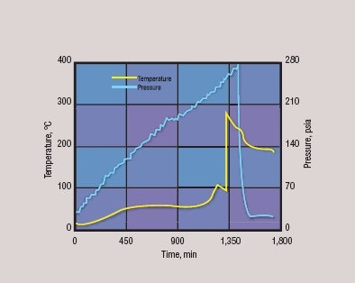

CSB Incident No. 1, self reactivity, thermal decomposition. Nylon polymer in a process vessel had decomposed to carbon dioxide and other gases. Because the foamy polymer fluid had blocked vessel tubing, operators opening the vessel were not aware of the trapped pressure. The partially unbolted cover blew off and the released hot fluid ignited. Following the incident, adiabatic calorimetric testing showed that the thermal decomposition of the polymer was endothermic with significant pressure generation (Figure 1) [17]. Closed-cell testing at Levels 2 and 3 over a temperature range that included the primary and secondary decomposition reaction systems could have identified and measured pressure formation behavior, including maximum pressure and pressure generation rate. Other reactivity characterization information for hazard assessment is onset temperature for significant decomposition, the difference between the main process temperature and the decomposition onset temperature and, from Level 3, the time to the maximum pressure generation rate under adiabatic conditions.
Figure 1
Thermal decomposition of a nylon polymer generated significant pressure that ultimately led to a fluid release and fire.
This incident demonstrates the importance of pressure as a hazard indicator and the danger of relying on a single indicator, such as the overall reaction energy, for hazard classification.
