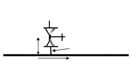

1. Don’t create deadlegs. When designing piping for steam sterilization, it is all too easy to create areas where air pockets form and, thus, steam does not fully penetrate and the proper temperature is not achieved. These so-called deadlegs are a concern because, if air is present, sterilization probably is not achieved. The only ways to truly detect a deadleg is with temperature measurements or indicator spore strips failing to be killed.
During validation, always place a thermocouple in all suspected deadleg locations to ensure the piping is not a deadleg. My rule of thumb for a suspected free-draining deadleg in a non-vacuum pump system is a length-over-diameter (L/d) ratio greater than 2.5. This ratio is the length of pipe with no steam flow, from the edge of the pipe with steam flow to the end of the pipe that has no flow, divided by the inner diameter of the pipe without steam flow (Figure 1).
Figure 1
The length-over-diameter ratio provides a useful tool for spotting potential deadlegs.
Obviously, any deadleg below horizontal is unacceptable, because condensate would not drain. For vacuum pumped systems I have seen L/d ratios of >6 used as a suspected deadleg. Twenty years ago, L/d = 6 was the limit of technology; today, L/d  ≤ 2 often is achievable.
