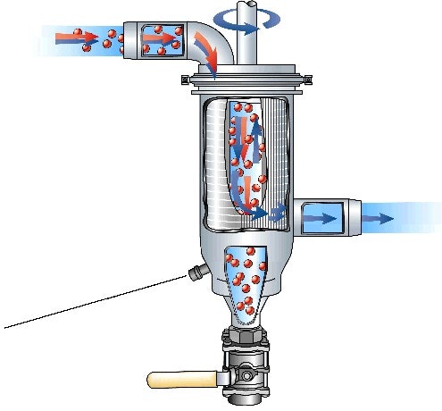

In contrast, the Eco Filter is a self-cleaning system that integrates directly into the pipeline and completely eliminates the need to change filtration bags. A spiral wiper design ensures the filter element is kept continuously clean, and so maintains optimum efficiency. Because of its self-cleaning design, cleaning of the filter between batch runs is quick and easy with minimal disruptions during production changeovers.
The totally enclosed Eco Filter prevents pollutants from outside the system from contaminating the product, and protects the operators from harmful fumes and spillage. This filter also features the Russell Filter Management System, to continuously monitor the filtration system, thereby enabling the filter to be operated efficiently without operator involvement.

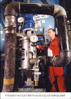

Figure 2. Filter at Neville plant
The Eco Filter also has a Q-Tap valve that allows the sampling of freshly filtered material, so the quality of the resin can easily be monitored on the fly without interrupting production (Figure 1). At Neville, use of the filters has resulted in substantial savings of both downtime and labor.

"I'm sure the Eco Filter has paid for itself in terms of productivity and waste elimination. But perhaps the health and safety benefits have saved us even more. We're safer now, and our workers love the Eco Filter system because it eliminates all those physical demands. It dumps all the junk directly into a drum. The filter does all the work (Figure 2)."
