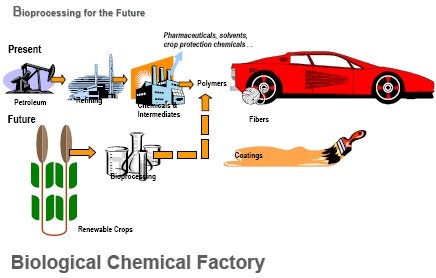

Figure 1. Biprocessing provides an increasing variety of products, including some commodities, with many more likely.
