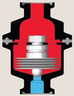

Bellows
Alcohol/water mixture sealed into a bellows vaporizes as condensate approaches saturation temperature (Figure 4).
Figure 4. The bellows trap is a good choice for vertical orientations.
The resulting expansion of the bellows closes the valve. Vaporization temperature increases as operating pressure compresses the bellows, in a rough approximation to the steam curve. This results in a cyclic action that modulates from a minimum opening on very light load conditions to full opening at maximum load.
The bellows trap is compact and light and can be mounted in any position. Main applications are small process, tracing, radiators and general. No strainer or check valve is required. Freezing is no problem, but water hammer can fracture the bellows resulting in heavy losses of steam.

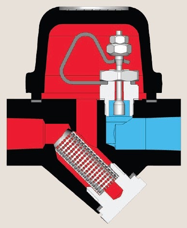

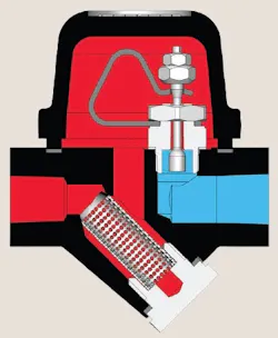

Bimetallic-thermostatic/thermodynamic
A third generation design, the operation is the same as bimetallic-thermostatic, except a single delta-shaped element is used (Figure 7).
Figure 7. The bimetallic-thermostatic/thermodynamic trap is good choice for compact, difficult-to-classify applications.
This design provides additional thermodynamic flow forces, developed in the downstream expansion chamber, to improve the hot discharge capacity right up to saturation temperature.
No strainer or check valve is required. This kind of trap is compact and can be mounted in any position. The main applications are drip leg, process, heating, tracing and general. Freezing is no problem and the single piece, bimetallic stainless steel element isn’t affected by dirt or wear.
