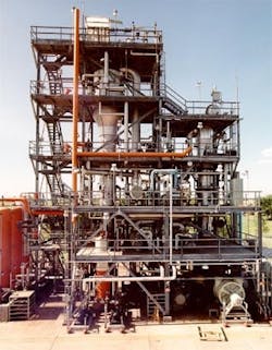

Industry depends upon the data and correlations developed by Fractionation Research, Inc. (FRI) (see sidebar). FRI generates performance data on mass transfer equipment under various conditions in two commercial-size distillation towers (Figure 1).
Figure 1. FRI has both high- and low-pressure commercial-size distillation columns.
If a tray or packing isn’t properly installed, the data and any subsequent correlations won’t reflect the true nature of the device being tested. So, FRI’s installation personnel have learned how to install distillation equipment with the skill and care necessary to measure correct performance. In this article, we share some of that practical knowledge. It will help you make sure that the tower you are erecting will work as expected. The advice also applies to absorbers and strippers.

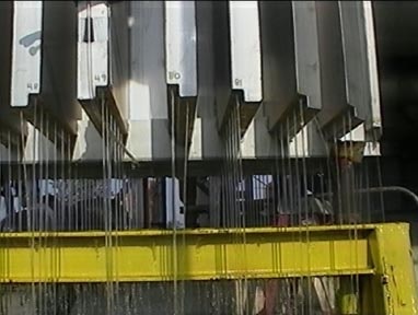

Figure 7. Unit undergoes flow testing before installation.
Industrial-size liquid distributors come in sections small enough to pass through a manway and are assembled in the tower with gasketed joints. Take care to ensure that the joints are sealed. It’s possible to have leaks in low-flow distributors with small orifices where a single leak flow rate can exceed the orifice flow. (See References 1 and 2 on the effects on performance of orifice layout patterns.) Whenever possible, we recommend water testing the distributor after assembly [3]. FRI installation personnel find it very useful to become familiar with a liquid distributor by laying it out before starting installation. This is especially true for distributors made up of many pieces. Be sure to check the liquid orifice size before installing the distributor.
Because the flow of liquid through an orifice is square root function of the liquid height above the orifice, doubling the liquid level causes a 41% increase in liquid flow. A liquid distributor designed for a minimum liquid rate at a 1-in. head has a 12% larger flow-rate on one side of the distributor than the other if it’s ¼ in. out of level from one side to the other. A way to minimize the effect of out-of-levelness at the minimum required flow rate is to increase the liquid head to 2-in.
Leveling a distributor to a tight tolerance is difficult. It’s best to make sure that the liquid distributor has a built-in leveling mechanism. FRI’s orifice pan distributors are hung on rods, with the length of the rods adjusted to hang the distributor the correct distance above the packing and assure levelness. With trough arm distributors, the individual arms aren’t exactly level with each other, so making sure they are level on average is the best that can be done, but keep in mind the effect of head variation on the flow through the liquid orifice. Any un-levelness can reduce tower performance especially at low flow rates.
Construction dirt left in the tower can plug up the orifices. This is especially true if the orifices are in the bottom of the liquid pool. The flow unevenness caused by dirt-plugged orifices can lower tower efficiency if the number of plugged orifices isn’t small and random. Plugged orifices also depress tower capacity by decreasing the capacity of the liquid distributor. FRI’s crews are careful not to introduce dirt into the tower during equipment installation and they inspect and clean the liquid distributor before closing the tower. Always check the cleanliness of the piping leading into the tower and clean the line if necessary. (References 4, 5 and 6 cover the effect of plugged liquid distributor orifices and their impact on performance.)
