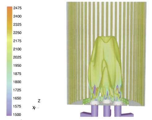

The new burner installation created unexpected and undesirable flame merging. The flame lengths were too long, causing high temperature peaks, which led to excessive NOx emissions. The length of the flame is often a critical burner parameter that plays a role in heat transfer uniformity to the process tubes. Rapid mixing of the fuel and air generates short flames that may lead to unacceptable heat transfer profiles, i.e., high coil temperature. Producing a fat flame may have other consequences: high peak temperatures and high NOx. However, if the flame is too long, it may impinge on the convection section and reduce coil life.
In this furnace, we observed that the flames from the different burners were coalescing into a single flame, producing a large ball of fire with high temperature gradients. The burner interactions significantly increased the length of the flame. This adversely affected NOx. Refinery engineers wanted a uniform temperature profile. They believed that this could be achieved by separating the flame into its individual components.
Figure 2. Burner interactions increased flame length and residence time, and caused spikes in temperature.

The CFD simulation of the original model closely matched the observations of the operating furnace in showing the flames from the individual burners coalescing into a single flame. This gave us confidence in the accuracy of the model. Looking at the flow velocities, pressure distributions and chemical species concentrations predicted by the simulation, we identified an unusually high proportion of unburned fuel within the inner circular area formed by the burners, indicating that there was poor mixing of the fuel and air.
The unmixed fuel didnt burn until it had migrated out toward the end of the flame, creating the flame definition problem. Based on this insight, we reduced the amount of fuel and increased the air to the inner circular area. We hoped that we could achieve a balance. Mechanically, this was accomplished by biasing the primary and secondary fuel injectors.
The first iteration showed a considerable improvement. We viewed the results and noticed that a fair amount of unmixed fuel still remained in the inner circle. Eliminating the fuel was the goal of the second iteration. After about a dozen virtual experiments, we modified the design and optimized fuel/air mixing throughout the furnace. The simulation predicted that the final design would provide excellent flame definition and temperature uniformity. We showed the results to the customer, who was very pleased.
The refiner wasnt looking forward to a long and disruptive experimental process to fix the problem. The customer approved the new design and John Zink produced the modified components. The retrofit was completed on the fly, avoiding furnace shutdown. Our new design worked exactly as predicted, reducing flame length to the desired levels and lowering NOx emissions to acceptable levels. Using CFD visualization required about 12 weeks to identify a solution, without disrupting current operations.
