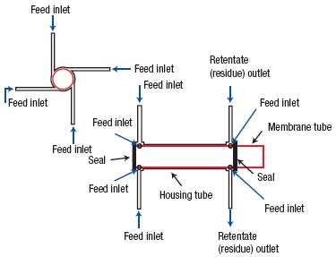

A revised module was designed with four tangential inlets evenly spaced around the circumference of the housing tube to improve the flow distribution around the circumference (Figure 3). A similar change was made at the outlet end of the module.
Figure 3. Changing the inlet and outlet configurations eliminates problems in the original module.
A CFD simulation of the revised design showed improved performance (Figure 4). Compared to the original design, the maximum localized CO2 flux is approximately the same. However, the average flux across the entire membrane surface is approximately 4% to 5% higher at intermediate flow rates. This performance enhancement is attributed to the reduction of dead zones in the revised design. Because of the swirling flow effect created by the tangential inlet/outlet ports more of the membrane’s surface is engaged in separating CO2.
Figure 4. Even at low feed rates, CO2 is evenly distributed over the media surface in the revised design.
