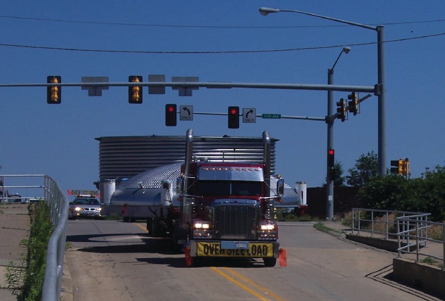

2. Be aware of wide loads. A wide load is a generic term for over-the-road shipments whose width exceeds 8 ft. or height exceeds 13.5 ft. (Length and weight restrictions also apply.) Western U.S. states have a legal height limit of 14 ft. When exceeding these limits, state (and sometimes city) “wide load” permits must be obtained — requirements vary by state — and driving restrictions such as dawn-to-dusk curfews are imposed. It’s always easier to obtain permits for excess width; states usually require at least one escort vehicle. When height limits are exceeded, utility company involvement and police escort become the rule rather than the exception.
Shipping arrangements are handled by the fabricator but it’s useful to know where the break points are for permits when developing your design. In general, a vessel 12-ft. diameter (or less) can be shipped with minimal permitting and attendant costs. This accounts for the deck height of a trailer and can mean the trailer must occasionally bypass an overpass. For larger diameters, the permit process gets more involved. A “stick trip” (travel of the entire route by a vehicle with a mounted stick to verify clearance prior to actual shipment) often is involved and the design of the equipment (i.e., location of nozzles and other external attachments) will impact the permit. If possible, orient attachments to minimize the load height. Purchase vessels of this size and magnitude from fabricators knowledgeable about handling wide loads. Experienced personnel will recognize if a vessel can be shipped in large sections (Figure 1) and then welded together and tested in the field.
As the vessel’s diameter, weight or length increase, shipping costs can become an overriding factor on which fabricators you invite to bid. Vessels more than 16-ft. diameter can only be trucked a short distance economically; hauling by either rail, barge, or shop fabricated in pieces and field assembled becomes the norm. Between 12-ft. and 16-ft diameters, it becomes very situational, so chose your bidders wisely. Moving a large vessel from the fabricator’s shop through a city to a major interstate or river can cost $10,000/mile and usually the most direct route can’t be taken. Factor in geographic location. It’s easier to ship wide loads in Western U.S. states than in the more congested Northeast.
