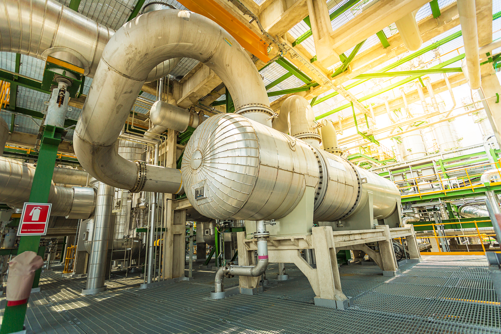

“Just build it to the Code.” That’s the most common response you hear during a design review that involves purchasing a new pressure vessel. Yet, there’re as many choices within the ASME code as there are when searching for your next vehicle. Smart choices can save you money during fabrication as well as over the lifecycle of the vessel. So, here, we’ll attempt to condense the 5,000+ pages (50+ lbs) of the ASME Boiler and Pressure Vessel Code, or “the Code,” as it’s affectionately known, into a simple guide when specifying vessels, heat exchangers and tanks. We’ll focus on 10 key factors.

In today’s chemical industry, too many engineers given the task of specifying welded equipment such as vessels, heat exchangers and tanks aren’t well versed in what’s necessary to develop an economic design that provides suitable safety and performance. Myriad choices must be made — and each will incrementally add to the final cost and schedule. When looking for savings, cutting the wrong corners may turn out to be very costly over the equipment’s service life.
