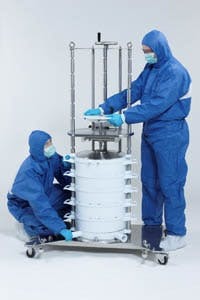

Value Plastics, Fort Collins, Colo., expanded its SF Series line of sanitary fittings by 16 products. The new fittings are designed to meet growing demands for heavy-duty parts with superior side-load strength and better flow. "Pharmaceutical professionals find this connector offers all the benefits of a disposable part while offering performance capabilities not found in earlier versions of flange fittings," notes Jim Pisula, vice president, marketing. In-Depth AdvanceMeanwhile, Pall Life Sciences, East Hills, N.Y., unveiled a flexible single-use depth-filter capsule system for demanding pre-filtration and clarification processes (Figure 4). The Stax system integrates as a pre-filtration step — for example after a disposable bioreactor — and makes it easier to develop a complete single-use process. "The Stax high-performance depth filter system has engendered a considerable amount of interest because of the flexibility of the system. Because capsules are available in three different surface-area configurations, which can be mixed and matched to give exactly the capacity required for any given process or batch size, and because the capsules can be used within a holder — which we call a 'chassis' — in standard bottom-in/bottom-out or bottom-in/top-out configurations, as well as having the useful function of being able to be operated with two different grades of capsules within a single chassis, users who have already installed the system are very enthusiastic," explained Ian Sellick, director of marketing.
Figure 4. Flexible filter: The design of this
system is said to makes it easier to provide a
Source: Pall Life Sciences.
