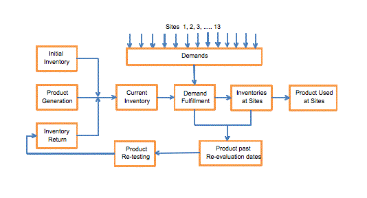

Figure 1. Model accounts for different demand and supply scenarios and evaluates re-evaluation-duration impact.

Background: Inventory was being built for potential launch of a new final product. The bulk material has re-evaluation timing -- the product must be re-sampled and tested to verify it's still acceptable for use. The tests can be costly and put a substantial resource load on the analytical lab. With the inventory build, concerns arose that a large quantity of lots could go past their re-evaluation dates. Extending the re-evaluation timing was an option but the impact of the potential extended timing on reducing lot re-evaluation was unknown.
Actions: We constructed a discrete event model to simulate the steps associated with product generation, inventory management and order fulfillment. At a high level, the model feeds items along two paths: those representing demands/product orders travel one path while those representing product flow travel the other. The paths converge, matching specific lots to specific demands based on first-in-first-out along with meeting the particular demand requirements. Product enters the model in two ways -- via initial inventory and a product supply schedule, both of which are read into the model at initiation. Thirteen sites order the product; one requests full product lots while the others want specific increments smaller than a full lot. So, the model must track residual lots. Before orders are filled, a check is made to verify that each lot involved is within dating requirement. Lots that go past dating requirements pass through a retesting loop before being returned to inventory. Checks again are made on dating requirements after hold times at the sites to simulate site inventories. Figure 1 shows a simplified flow schematic of the process.

Inputs to the model included:
• initial product inventory -- lot numbers, dating information and quantities for each specific lot in inventory;
• demand schedule -- monthly orders from each customer;
• product supply schedule -- lot numbers, dates and quantities for product supplied into inventory;
• re-evaluation duration -- number of months from manufacture date until product needs to be re-evaluated; and
• site inventory hold times.
• Outputs from the model included:
• demand filled table -- specifics on which product lots and quantities were used to fill each order;
• lots past re-evaluation dates -- lot numbers, quantities and timing on when lots went past re-evaluation dates; and
• final inventory -- attribute data for lots still in inventory at the end of the simulation.
Results/output: We performed multiple simulations, looking at different demand and supply scenarios as well as the impact of potentially extending the re-evaluation duration. Output results, such as number of lots going past re-evaluation dates per year, were captured for each scenario and compared. We then calculated the re-evaluation testing loads and costs for the analytical labs for the different scenarios. Figure 2 shows the impact on "cushion time" (the days remaining from when an order was filled until that lot goes past re-evaluation timing) for two re-evaluation timing scenarios.
